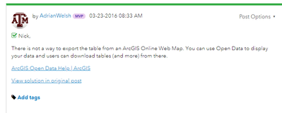

For attributes why not use a table widget and export to csv?

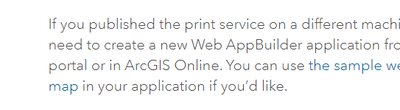

Thanks for the links, but I’m looking for a way to do this in ArcGIS Online, without a portal or a server.
Laura
by MVP Regular Contributor
Those links work for AGOL too, as listed in the documentation.
SanMateoCountyDPW
They work for AGOL but cannot be created there. You need a portal or a server.
