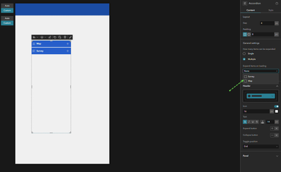

Hi!
Accordions are most often used for hiding and showing sections of related content. It shows item by clicking the + sign aside item.You can also chose how many items will be expandet.
Happy New Year to you too.

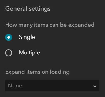

jessneuner
Thank you @Faiez !
The trouble I'm having is that the drop down for the 'Expand Items on loading' is empty ... seems like I should reach out to Tech Support.

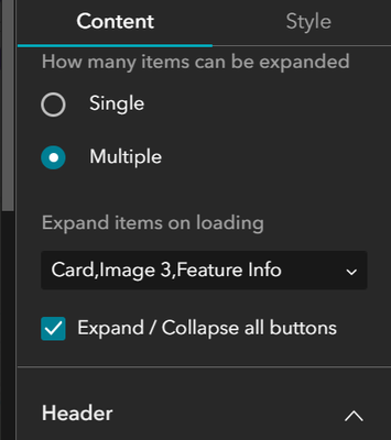

Faiez
Hi Jessneuner!
The accordion widget is just a container for other widgets. It is empty until we put other widgets in it. In the example above it is shown empty, because there is no widget inside.

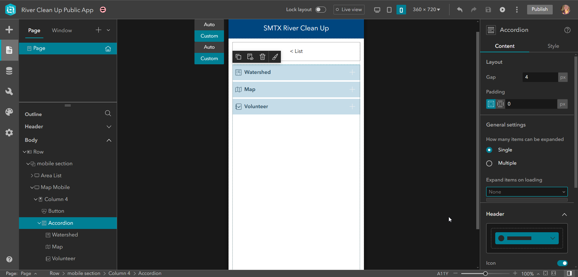

jessneuner
Thanks, @Faiez  -- Yep.
Finally figured it out --- It seems to happen when i put the configuration into "Custom" -- like to alter the UI for mobile vs desktop -- then that drop down goes empty.  I'll get a bug submitted.

@jessneuner Hi! I am having the same issue with the accordion when working with Custom Mobile view, where the dropdown does not populate. Were you able to get any response from your bug submission?
jessneuner
hi  @beaniid  -- no 😩 i still need to report to Esri.  We worked around it with two different applications --- then embedded the mobile version into the desktop version --- so it's still one app for the end user ... i'll comment back here once i get it reported.
beaniid
Yeah, I will get around it by splitting my accordion into 2 and putting a row in between for the item I want to be always visible, but it would look much better and be more useable if I could just set it to always visible in the accordion. Thanks!
ZhenZhang22
Esri Alum
Thank you for your feedback! We identified the same issue and have fixed it in the February 2025 release of ArcGIS Online. Please give it a try.
