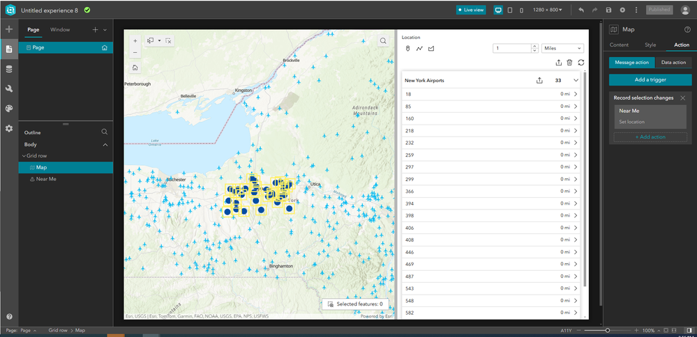

Hi @SteveCole ,
You can enable select tools from map widget and set  a message action record selection changes -> Near Me -> Set location. Could you please give this a try and see if this helps your workflow?
image.pngWidgets and tools are flexible and can communicate /work together in Experience Builder.  That is the reason we intentionally avoid adding all functionalities together in one widget, it makes the updating process more difficult, for example, if a new functionality is being added to Select widget, users will want the same one in Near Me as well, so basically we have to update in two places which will introduce more bugs.
