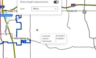

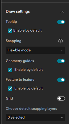

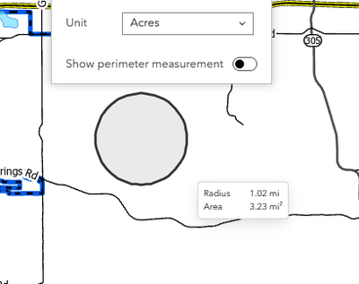

Hopefully I understood correctly what you are looking for.
The Draw Widget has a Tooltip option in the Draw Settings dropdown. This setting much be enabled by default for end users. Once enabled, a white measurement box will appear next to the cursor while drawing and display the distance.
The only feature the Draw Widget does not provide, to my knowledge, is creating a buffer after drawing.
See the screenshots below for reference.

@MariusVerdes to my knowledge, I do not believe we can put in a specific length or radius. I believe that would be a good edition to Experience Builder. I haven't received any of those requests from my end user, but I bet once they learn how to do it they will like it better. If you put in another idea of just the typed in value, I give you kudos for it. More kudos the more likely they will implement the idea.
