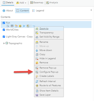

Hi Emma,
You can customize your map pop-up using Map Viewer.
Open your map in Map Viewer, go to Details - Content, and click the more option button under each feature layer. Then you can see "Configure Pop-up".
Regards,
Shengdi

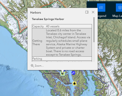

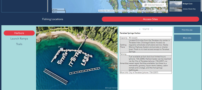

My problem isn't configuring a custom pop-up (that's what I've already done, and it's looking great), it's that the Feature Info Widget in EB is configured only using the Map Viewer pop-up. Like I explained in my original post, this creates redundant information for users between the Map EB widget and the Feature Info EB widget. When they click on a point in the map, the pop-up is the same display and information as the Feature Info widget. They would rather only have the Feature Info widget with no pop-up. OR better yet, if the map pop-up could have just the site name, and a button that jumps to the Feature Info widget below the map with more detailed information, that would be great. But at the moment, you can't configure the two separately.
Here is my map pop-up:
And below the map, is the same information, which is the preferred view:

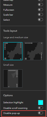

ShengdiZhang
@EmmaZHatcher @ZacharyVavra @MarceloRosensaft @TanGnar
You can disable the map pop-up from the map widget settings. When the pop-up is disabled in ExB, you can still keep the selection on the map. However, disabling takes effect on all layers used by the map widget and cannot be configured separately.
Regards,
Shengdi
