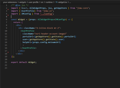

Hello,
You can add it in a widget like this.
SaiBharadwaj
Thank you very much @henrilebon974 . I will try to implement this.
