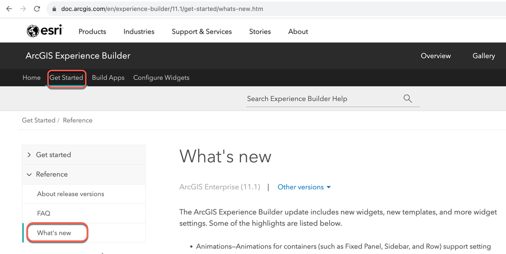

Jianxia
@JoeHershman , new features in Experience Builder in ArcGIS Enterprise are documented under ArcGIS Experience Builder ->Get started->Reference. Taking ArcGIS Enterprise 11.1 as an example.
https://doc.arcgis.com/en/experience-builder/11.1/get-started/whats-new.htm
ArcGIS Enterprise 11.2 takes new features from ArcGIS Experience Builder in ArcGIS Online February and June releases except for beta features. Also 11.2 adds support for editing related records which is not available in ArcGIS Online until the October release. So, you may take a look at the following blogs for upcoming new features in 11.2
What's New in ArcGIS Experience Builder (June 2023)
What's New in ArcGIS Experience Builder (February 2023)
