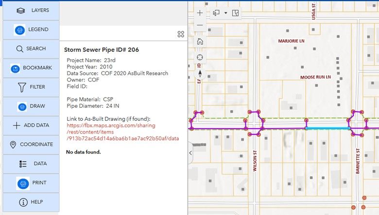

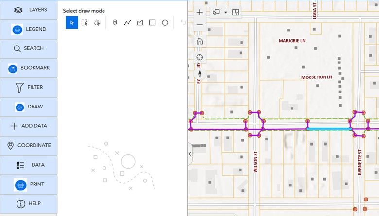

Hi @Jianxia
I will clarify my request to open the Feature Info widget when clicking on a feature on the map.
I am trying to replicate the behavior of the Instant App Sidebar template, which will open the sidebar to the Feature Info tool when clicking on a feature, regardless of whether the Sidebar is collapsed or currently displaying another tool.  I find the behavior of the sidebar in the Instant App very user friendly and seamless, and it would be great if ExB could replicate it.  One of the great features of the Sidebar is it opens the widgets full height and not over the map, so the user does not need to resize or move the widget window.
In ExB, I am using the Sidebar Template and have added a Section widget to the Sidebar. Within the Section widget I have added 12 views, one for each Tool I wish to add.  I have added a tool widget to each view, one of which is the Feature Info widget. I have added a column next to the Section with 12 buttons that open each of the views. I prefer the look of buttons to the Views Navigation widget. It will be very common for a user to have a widget open other than the Feature Info, such as Layers or Legend, or perhaps even have the Sidebar closed. Then they may click on a feature on the map, expecting to see a pop-up. But no pop-up info will be visible unless the user clicks on the Feature Info button. This in not intuitive for the user. I would like the view to switch to the Feature Info widget when clicking on a map feature, not matter what widget is currently active, or if the Sidebar is currently closed.
Attached is a screen shot of a feature selected on the map while the Draw widget is active - note that no data is displayed.
Selected Feature; Draw activeSelected Feature; Draw active
Then a screen shot after I clicked on the Data button, which opens the Feature Info widget.
MapFeature after activating FeatureInfoMapFeature after activating FeatureInfo

@TomDuncanGIS , Thanks for sharing. The design looks neat! Adding a default template similar to the Sidebar Instant apps or the Tab theme in Web AppBuilder is on the roadmap. As for displaying Feature Info in your case,  unlike Instant apps, clicking a feature on the map could evoke other widgets like selecting a feature on the List widget or highlight it in the Table widget, therefore this is a little complicated. In the October release, we plan to add an option, allowing you to dock the pop up in a pre-defined position like top-center, top-left, or bottom-right, etc. When end users click a feature, the pop up will display in the position you configure in the Map widget. Will this meet your need?
Also, the Widget Controller adds a fixed option in the June release so you can display all widgets in a fixed panel size and position, similar to what WAB does.

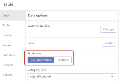

@ChipMorgan65 , thanks for the detail description. See comments below regarding your questions:

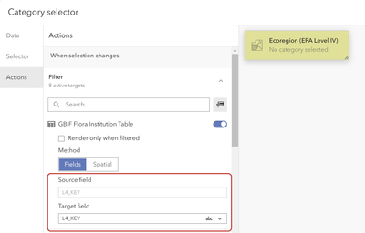

#1 Utilize foreign keys/target fields in filtering data across layers.
The Group Filter widget in Web AppBuilder allows you to filter data across layers. This capability will be available in the Filter widget in Q1 2024.
#2 Summary table.
Currently there is no plans to support this capability in the Table widget. However, you can group features to summarize statistic values using the Near Me widget. See the Recreating Web AppBuilder Info Summary widget workflows in Experience Builder blog.

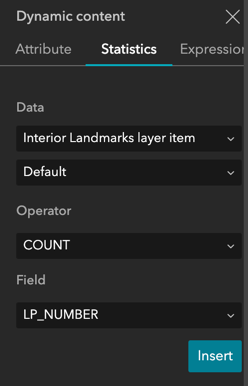

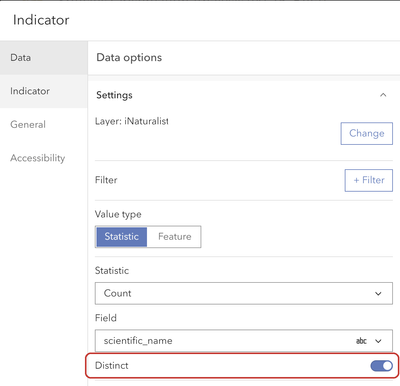

#3 Distinct count of a text field.
The count operator in the Dynamic Content menu should count unique values automatically when you choose a field other than object id as documented under Dynamic content->Statistic:
"Results can be the maximum, minimum, average, or sum value of a numeric field; the maximum or minimum of a date field; the feature count of the feature set (using the unique ID field); or if the service supports distinct count, the number of unique values for a field."
Could you give #2 ad #3 a try and see if they fit your requirements. Thanks!

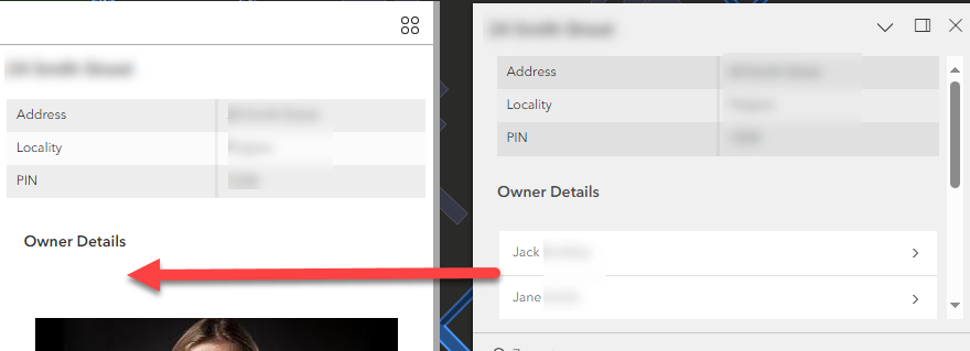

Cory_Williams
hi @Jianxia
Sorry, I meant to say, related objects in the Feature Info panel.
In the popups, they appear correctly, however the Feature Info panel doesn't display the related items, as they are configured in the popup.
This is something I just mocked up as an example.
Left is the Feature Info panel and on the right is the standard poup.
You'll see under Owner Details, on the left, it's just blank and doesn't display any records.
Jianxia
@Cory_Williams, This is a known issue. We plan to address it in 2024. In fact, Experience Builder does not support for displaying related records in Feature info, Table, Query widgets, etc. It is one of the important capabilities that has not been migrated over. Your request has been added to it.

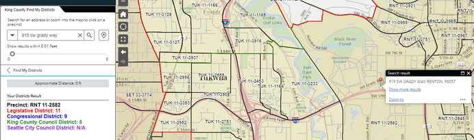

RamonPierce1

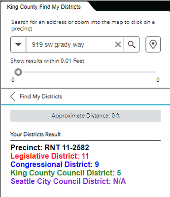

Hi @Jianxia
Will the new NearMe widget eventually have the functionality to display results, via an inputted layer file, like in the screenshot below?
I currently have a WAB that returns major districts from an inputted address and zoom to the address on a map. I want to replicate this in Experience Builder. Thanks.
