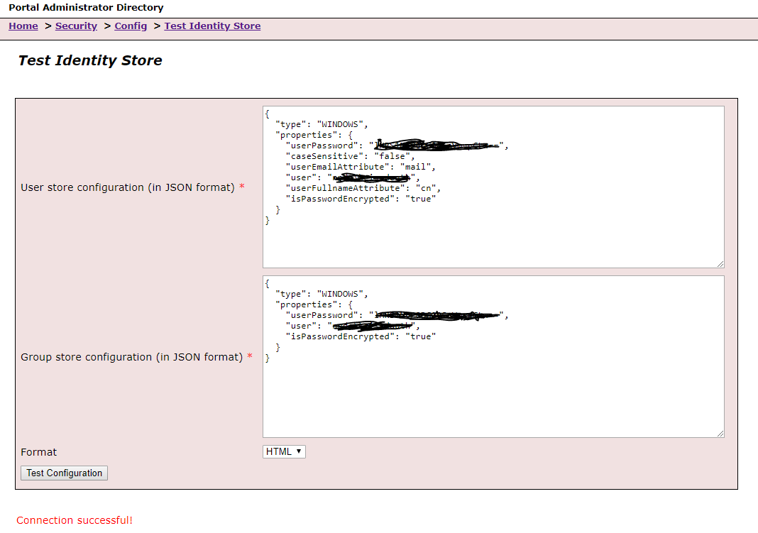

I've updated the Portal Security Configuration with the required AD parameters in json format as per the documentation.
I can successfully test the identity store and the connection is returned as successful.

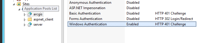

I then go to the iis server manager and select the portal webadaptor 'arcgis' and Disable Anonymous Authentification and Enable Window Authentification.

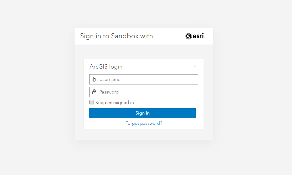

However when I go to the portal URL i'm challenged for credentials and it appears that Portal requires a token to login?This isn't what I was expecting.

With I.E. and Chrome and Firefox (anonymous Disabled and Windows Authentication Enabled) the browser is still returning the following URL
https://gissandbox.npdc.govt.nz/arcgis/sharing/rest/oauth2/authorize?client_id=arcgisonline&display=...
If I re-enable anonymous access along with Window Authentication I can login at the prompt using my active directory credentials
I then appear to be logged in with my active directory account however this isn't sign sign on.

Not sure if you are still seeing this issue with web-tier authentication not working but one suggestion I have would be to enable anonymous access to your 'arcgis' web adaptor and then re-register it with your Portal.  Once registered, re-enable the Windows Authentication and try it again.
I've seen instances where the IIS web adaptor thinks it is registered and properly forwards the requests to Portal but Portal does not think it has a web adaptor or the web adaptor information has somehow become corrupt.  The behavior in these cases is very similar to what you described.  The web-tier authenticated user is not automatically logged into Portal.  The user has to manually type in the username/password at the sign-in window.
