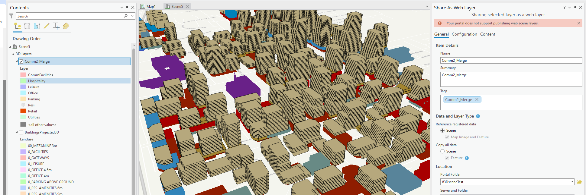

We have multiple Enterprise deployments in version 11.1.
It is possible to share as web layer of 3D multipatch, raster tile layer from a DEM  and elevation layer from DEM in one of such instance. However in an identical deployment, the share as web layer for 3D multipatch fails where as raster and elevation layer from DEM works.
The only option is to create a slpk file and then upload directly to the portal, however the hosted feature service is then not created.
Any suggestion how to resolve this?

Except the one shown in the screenshot, nothing else
