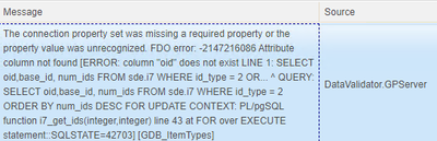

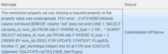

I upgraded ArcGIS Enterprise from 10.7.1 to 11.3.  Every upgrade (Portal, Server, web adaptors, Data Store) reported success on the upgrade.  When I validate the relational data store, it fails with the error message:

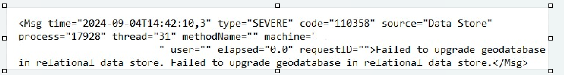

Checking the log files, I see

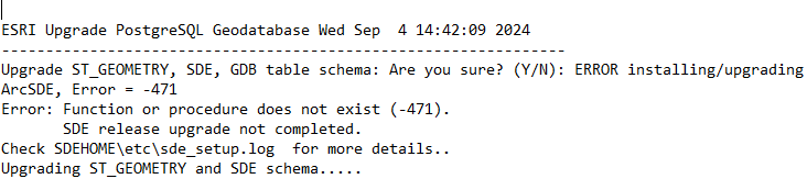

If I connect to the relational data store, it says that the database is version 10.7.1.  I tried to connect with ArcGIS Pro, but it fails to connect with error: Database Connection: FDO error: -2147216086.  So it appears that the Data Store upgraded to 11.3, but the underlying relational data store is still at 10.7.1.  How can I get that database upgraded or get it to validate properly?

Esri says that it has worked for some customers to execute C:\Program Files\ArcGIS\DataStore\bin\gdbupgrade.exe.  This did not work in my situation.
