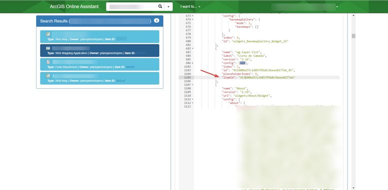

We have this problem after migrating from 10.8.1 to 10.9 and we found a solution!
After comparing a 10.9 WAB config application with a 10.8.1 config we notice that the property "uri" doesn´t work anymore for the custom widget. The property needs to change to "itemId" referencing the ID of the custom widget of the Portal.
So, we opened the web map applications at AGOL Assistant, and fix these properties to all custom widgets and the application works again.

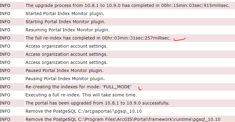

Did the step about re-index portal items complete successfully?
Hcemince
I've checked the portal logs

I would expect the upgrade to take about 8 hours. The 15 min line above seems to indicate the update flopped with a false positive log entry.
Hcemince
in this case, we will run the portal setup again. But this time, it will be a repair setup type.  Am i right?  Because,  It wont be detected as a update, I guess...
