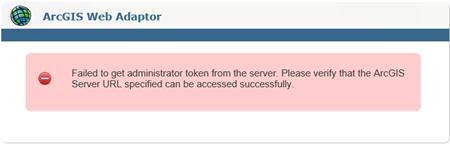

On a separate Windows Server 2016 DataCenter Azure VM, I installed a Web Adaptor and after attempting to add the ArcGIS Server above to the configuration, I received the following error:
If I install the Web Adaptor on the same VM as ArcGIS Server then it all works out fine. However, the goal is to have a separate VM for the Web Adaptor.

Hello,
How are you registering the Web Adaptor with the ArcGIS Server? Are you using the hostname of the ArcGIS Server or the IP?
