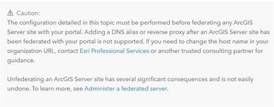

Thank you for this input. With the change to the new naming pattern for the Web Adaptors, what will happen to the content that is already in Portal site from the existing federated server? As it stands now, those services use the "arcgis" web adaptor name (EX: https://gis.domain.org/arcgis/rest/services/pointsLayer ). Will I need to un-federate & re-federate my AGS with Portal? Will I need to remove and re-add these layers?
MarceloMarques
@KevinPiraino2 - I discussed this with other collegues and the feedback that I got was.
https://enterprise.arcgis.com/en/portal/latest/administer/windows/using-a-reverse-proxy-server-with-...
Question: Does Esri supports to rename the webapators ???
Answer: No, it is not a supported workflow.
Questions: Can Esri Technical Support assist to rename the webadaptors???
Answer: No, it cannot, it is not a supported workflow.
Question: Can Esri Professional Services assist to rename the webadaptors ???
Answer: Yes, Esri Professional Services has tools and methods that can be used to rename the webadaptors, the customer can reach out to Esri Professional Services for assistance.

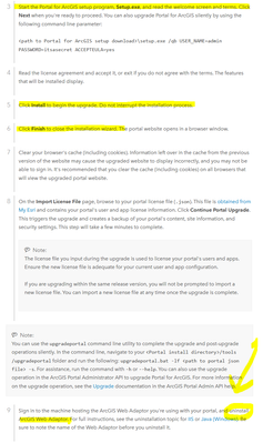

EricKriener
Hi @MarceloMarques , is removing the webadaptor first still the case?
I have never done it that way before...in fact, your latest doc has it in the order that I've always done it...
https://enterprise.arcgis.com/en/portal/latest/install/windows/upgrade-portal-for-arcgis.htm#ESRI_SE...
Section #9 (AFTER the portal upgrade)
Asking b/c I had problems with the webadaptor on two separate machines, one portal and one server, last night trying to upgrade to 11.2 and had to roll back to snapshots.
thanks.
MarceloMarques
@EricKriener - the 11.2 documentation says that you can uninstall / install the Web Adaptor after the Portal Upgrade and after the Server upgrade. I have always done in this order as well and I have never run into any issues.
Upgrade Portal for ArcGIS—ArcGIS Enterprise | Documentation for ArcGIS Enterprise
| Marcelo Marques | Esri Principal Product Engineer | Cloud & Database Administrator | OCP - Oracle Database Certified Professional | "About: In 1992, I embarked on my journey with Esri Technology, and since 1997, I have been working with ArcSDE Geodatabases, right from its initial release. Over the past 33 years, my passion for Spatial Databases and GIS data has become a central part of my career.." | “ The mountains are calling and I must go.” – John Muir |
EricKriener
no, it doesn't @MarceloMarques ...did you read the link I sent?
MarceloMarques
@EricKriener - it seems that the 11.2 doc was rectified, previous versions 11.1, 11.0 of the documentation we were left with the impression that we had to uninstall the web adaptor first and then perform the upgrade, I personally had always uninstalled / installed the Web Adaptor after the upgrade and I never had issues.
