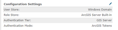

Hello all,
I am moving my organization from a stand alone ArcGIS Server 10.8.1 to a new installation of ArcGIS Enterprise 11.1 Server federated with Portal (on a different server data center with a different domain etc). I currently have 100 pages of ArcGIS Server user names in the ArcGIS Server Manager and the configuration settings say the user store is using an existing enterprise system - Windows Domain.
A few questions:
Can I get a list of the user names exported from ArcGIS Server Manager? I'm not sure how this works. Is it every single person on our domain that got automatically added as a user in this list when it was first installed?
I need to get these users into the new environment in Portal 11.1.
In this new environment we will have some outside users that will not be part of our Windows Domain. Best practices and ideas on that?
I'm thinking of just using the built-in Portal identity store. Do I have to manually enter this 100-page list of names?
I appreciate any insight you have on this.
