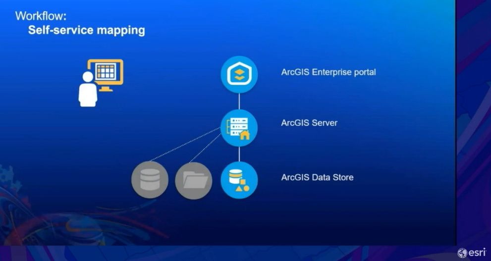

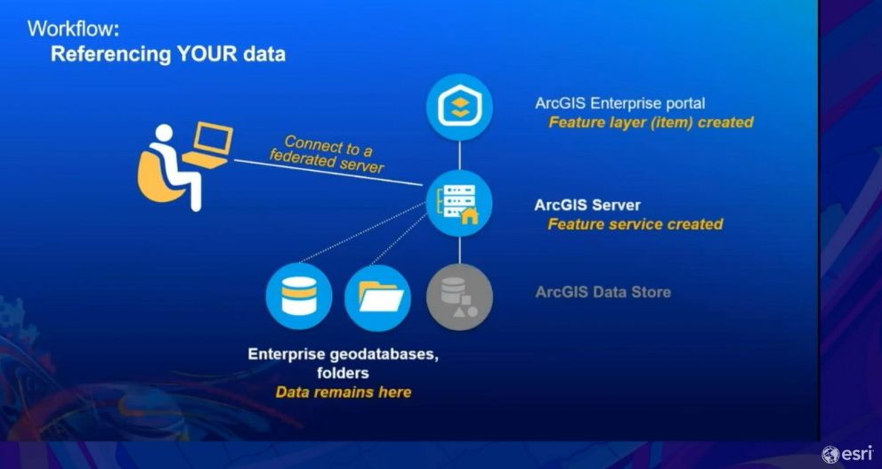

I got this video that explains the functionality of “data store”,
https://www.youtube.com/watch?v=_LFzszE6bKc
When publishing data with ArcGIS Online, there is no option to reference (register) the data to avoid copying it to the server, and thus it’s compulsory that the data will be copied to cloud! I think that the “data store” has the same functionality; it’s equivalent to copying the data to cloud
Jamal Numan

Referenced data is published as a Map Service or Map Image Layer, depdning on preferred terminology.  It uses an older publishing technology that uses ArcSOC.exes on the server.  Each uses memory and has a compute footprint.  All of that means that architecturally you can only scale so far, i.e. deliver a finite number of map services.  You can make those map services into feature services for editing, but you use even more memory etc.  If you're using Dedicated Service Instances then ~100 is the arbitraty max number of services from a single ArcGIS Server Site.  If you use Shared Instances then you can have hundreds of services.
Hosted Feature Layers can only be provided from a base deployment of ArcGIS Enterprise, it needs the Portal, Hosting Server and Data Store.  Put them together and you have a lightwweight architectural paradigm that could allow you to stand up 10,000's of individual services.  However, you're presenting data not maps, subtle but important difference.
Also some functions inside of a Portal (analytics/Insights) use Hosted Feature Layers as temporary storage.
Basically, if you want to use Enterprise, you need a Data Store.  It's down to you how you publish.
In summary, Hosted Feature Layers from the Data Store scale better.

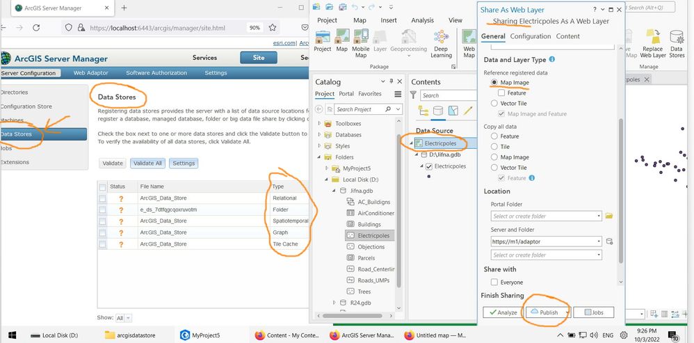

Till now, I couldn’t figure out the function of ArcGIS Data Store. How can I touch its benefit?
For example, in the screenshot below, what is the difference between publishing the “electricpole” service with or without having the “ArcGIS Data Store” configured?
