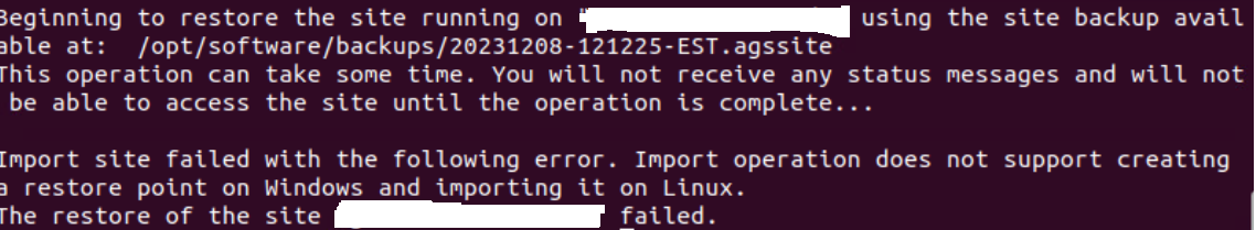

I've been trying to import ArcGIS Server services and a site configuration from a Windows environment to a Linux server. However, I've encountered a significant issue that's hindering my progress.
Error Message:
When attempting the import, I receive the following error message:

The error message you are receiving is telling you what the issue is. You can't do a backup/restore from Windows to Linux. Like, you can't take a WebGISDR backup from a Windows environment and restore it to a Linux environment. And the same goes for the individual components too, I believe. Like Portal, Data Store, and Server.
I'm not aware of any workarounds except manually recreating all of your content.
