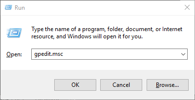

1.  On the ArcGIS Server machine, open Local Group Policy Editor by going to Start > Run > gpedit.msc

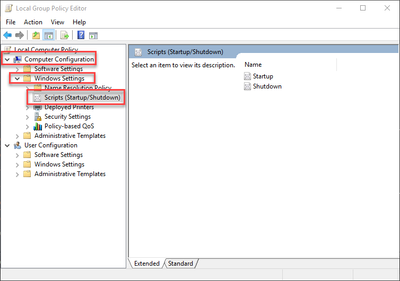

2.  Navigate to Computer Configuration > Windows Settings > Scripts (Startup/Shutdown)
3.  Double-click Startup

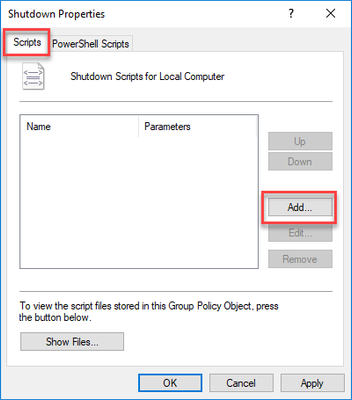

4. Under the Scripts tab click Add

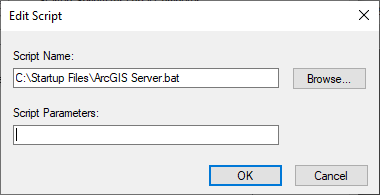

5.  For Script Name browse to the .bat file created previously
