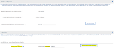

We're in the mist of updating our map config, after moving to Maximo 7.6.1 and Enterprise 10.8.1 using secure feature services. Are you using web services from Enterprise or a web map from Portal for the Maximo integration? If it's just web services you shouldn't need anything in the Web Map Configuration section.
Under Map Security tick the Enable Token Security box and then enter the credentials. This assumes all services in use are secured with the same user and password.
