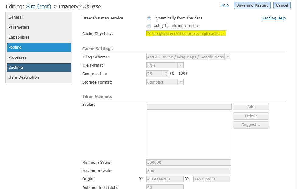

I'm trying to identify which directory is being used for a map cache on one of our servers so that I can clean up some folders.  There are two map cache directories and I'd like to delete one of them.
I figured i'd look in site manager to see which one is being used by the service.
Unfortunately the full path of the directory is too long to display in the drop down.
I'm looking for suggestions on how I can confirm the directory being used so I can clean up the directories not being used.

@DavidPike is correct if you switch to "using tiles from cache" and the tiling scheme box remains empty. Either the cache structure in the D:\ location has been modified and the map service can no longer find the conf.xml in that path (<cache directory>\<service directory>\ImageryMOXBase\conf.xml or since this is deployed to the root of ArcGIS Server, <cache directory>\ImageryMOXBase\conf.xml); or there is in fact no cache in the D:\ cache directory.
To change the cache directory, you need to first stop the service.
You can also check the available / configured cache directories for this ArcGIS Server Site

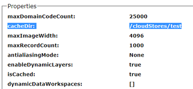

If you want to dig deeper, you can also use the Admin web page to look at service configuration properties
https://<myserver>/<server wa name>/admin/
navigate to the service, and find the properties section, and look for cacheDir and isCached property values

There's no cache for that service.

HenryLindemann
Hi Navigate to your ArcGIS server admin directory and then the service you will find the cash dir there
https://dns/webadaptor/admin/services/myservice.MapServer
