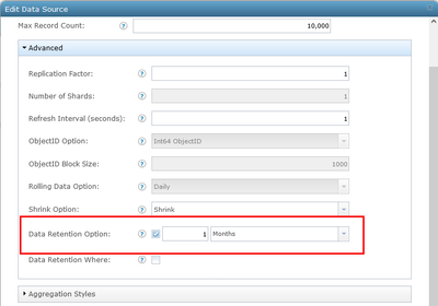

How long of a time frame do you plan to keep the historical records for (i.e. 6 months, 1 year)?  There is a data retention option for a Spatiotemporal Data Store you can set.
