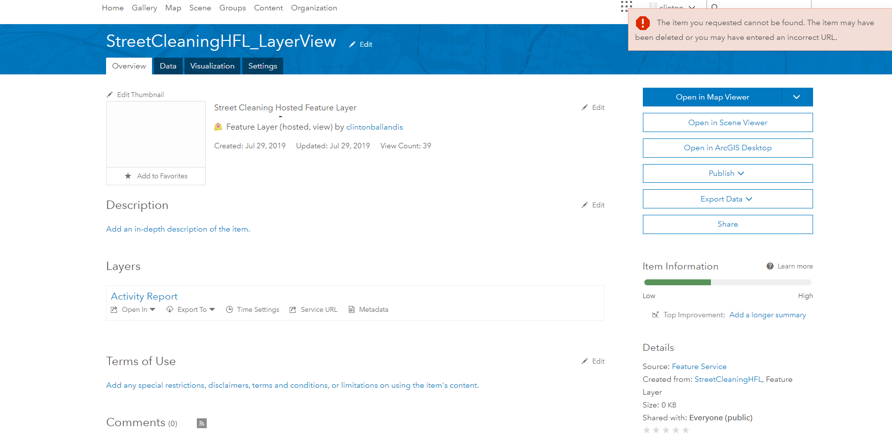

Hi all,

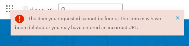

I've created a hosted Feature Layer with 22000 features. I then created a Hosted View to stop user from having editing access. While the view seems to have been created successfully I get the following error.
This is weird because I can open the view and access the rest end point. All the attribute information looks correct. I can even use the view successfully in a Web App.
If I log out of Portal and log back in a then go the the hosted view's item details I get the same error.
We're running ArcGIS Enterprise at 10.6.1. I can't see anything in the Server or Portal logs.
Any ideas?
Thanks,
Clinton

I've done a little more research on this error and I found the following in Chrome Dev tools
{"error":{"code":400,"messageCode":"CONT_0001","message":"Item does not exist or is inaccessible.","details":[]}}
This error is similar to the main error (below)
I've found that I can resolve these errors by going into the visualizaton tab of the hosted layer view and changing the symbology of the view then saving the layer. If I then click on any of the other tabs e.g. settings or overview I'm prompted with save changes.
I can click either yes or no -  the error messages above are no longer returned. Its really weird that changing symbology fixes this?
