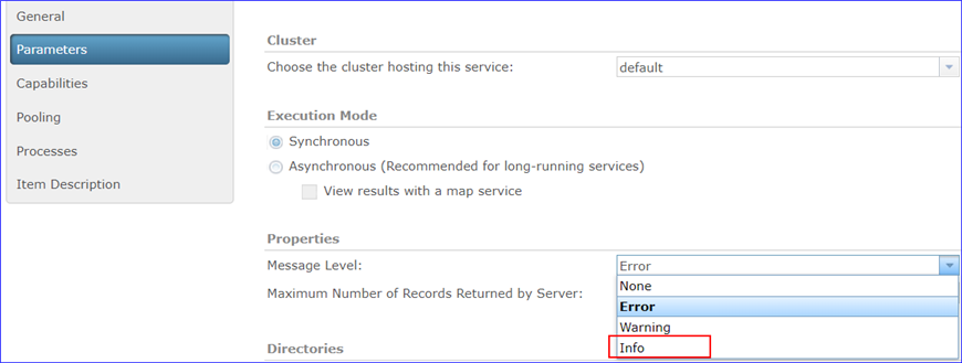

'Unable to complete' is a very generic message. It does not give you much info why it is failing.
I'd suggest you to change your print service message level to 'Info'
and check what is the message returned by the service when it fails. If you use web app, then you can use browser's Developer Tools to check the network traffic to find that out.
also, pls check the Server log.
