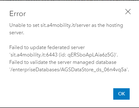

I am trying to set a federated server as the hosting server of my portal for ArcGIS (all is version 10.7.1).
When I try it, I receive the following error:

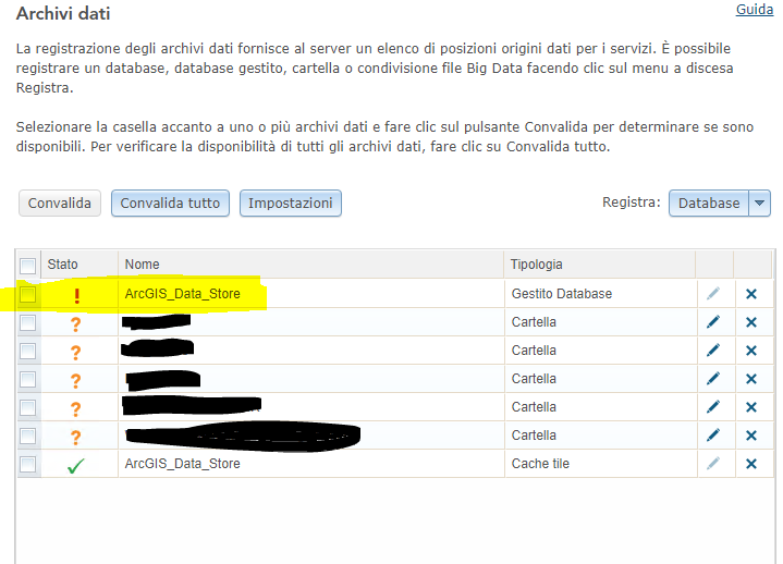

In ArcGIS Manager, I can see that I have an error when trying to validate the Relational data Store:

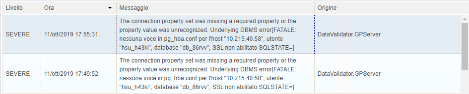

In the server log I see this error: The connection property set was missing a required property or the property value was unrecognized. Underlying DBMS error[FATALE: nessuna voce in pg_hba.conf per l'host "10.215.40.58", utente "hsu_h43ki", database "db_86rvv", SSL non abilitato SQLSTATE=]
How can I fix this error and be able to set the hosting server?

That could be a possibility, but I did notice that you also have a Tile Cache that validates. Do you have anything hosted in that Data Store?
AlessandroValra
Nope, but I guess I have a buggy installation.
I tried the WebGIS Dr initially (on a 10.5 version), but that didn't work.
So I tried the exportSite/importSite approach for migrating the single machine deployment onto another server.
Most likely this approach has led to an unstable installation and trying to fix everything is getting tedious. I guess it's time to reinstall everything from scratch.
