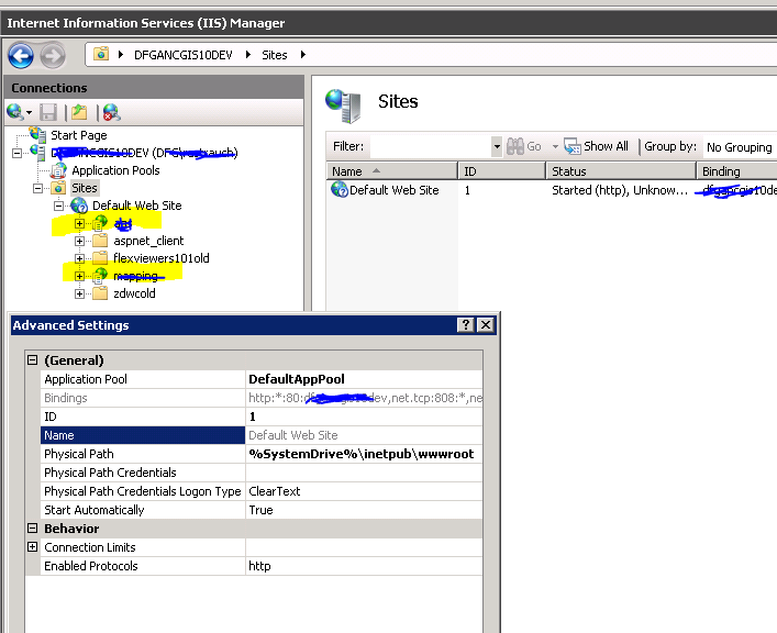

  • So although the web adaptor install would not actually install IIS, it will install an folder/application with the name you give the web adaptor.  If you haven't created a IIS "site", this will go under the "Default  Web Site".  For testing and internal use only, and you plan to only have one root .com name, this may be fine.  But if you plan to have multiple (for example, we have on for each of our divisions), you would want to create Sites (in IIS manger), and set it up with the IP and the open 80/443 ports.  Then when you install the web adaptors, they go under those sites, as appropriate.

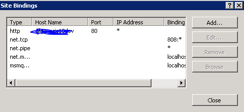

    • For examples, on  on my 10.4.x test machine (internal only, two web adaptrors (one set for public, other set for secure....these are separated to help me keep things organized when setting up the proxy)  My setup looks somethings like this (not accessible from outside our network, on purpose) notice, that is only has a Default Web Site, and although the Bindings show port 80 and any available IPs (*), none of the IPs on this machine have port 80 or 443 open.  I have two web adaptors installed on this machine (one for 80 and one for 443) which I have highlighted (and names blanked out) on the first image.

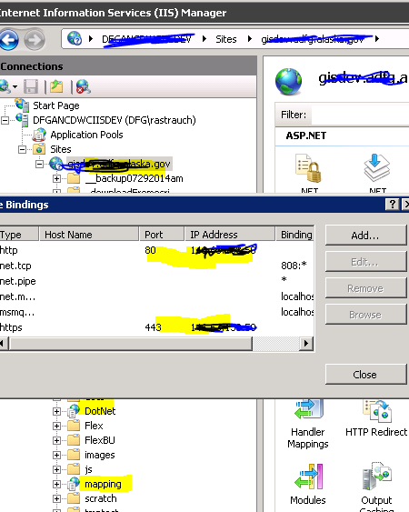

    • On the other hand, I have my test machine setup with a ".com" type name, and ports 80 and 443 are set up so I can access them outside my domain/network.  I have multiple webadaptors for this address (one for public, one for secure) and I also highlighted the DotNet proxy folder/application (default name).  For this machine, I can access with the http://machine:6080/arcgis/rest/services     https://machine:6443/arcgis/rest/services   or the machines IP:<port>, or localhost:<port> (if on the machine)    OR  http://<....alaska.gov>/mapping/rest/services   with no port number to see the public services (not listing the secure web adaptor).

  • you need your IIS (or other web) setup with a ".com" type name (FQDN?) and ports that can be seen by the outside world....whether that is the www or just those in your network
  • you want to setup web adaptor(s) for that machine
  • then you want to access the \rest\services with
    • using you machinename/IP/localhost and :6080 or :6443 and no web adaptor (just default arcgis)
    • or the      <FQDM>\<webadaptor>\rest\services   no port is using 80 or 443
