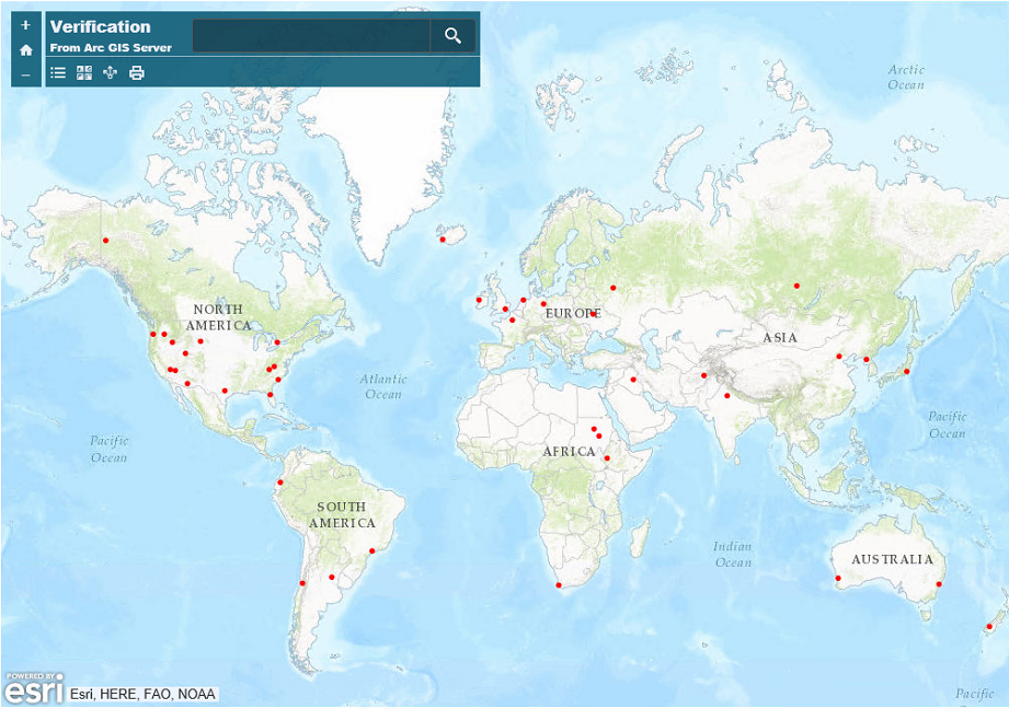

I'm currently testing an ArcGIS Server (10.3) deployment. I've published a sample geodatabase and map as geodata and map services on the server. I've linked these services with our ArcGIS online account and created a web map and web app from them. My issue is this: I can view the data with attachments on the web app from the web browser on the server. If I view the same page on the web browser on other computers, I can't see the data. I have everything set in the server manager and on ArcGIS online to share with everyone(public). Is this an issue in the IIS manager on the Windows Server, or on the ArcGIS server itself? Currently our server is local to our network.
Web browser on the server:

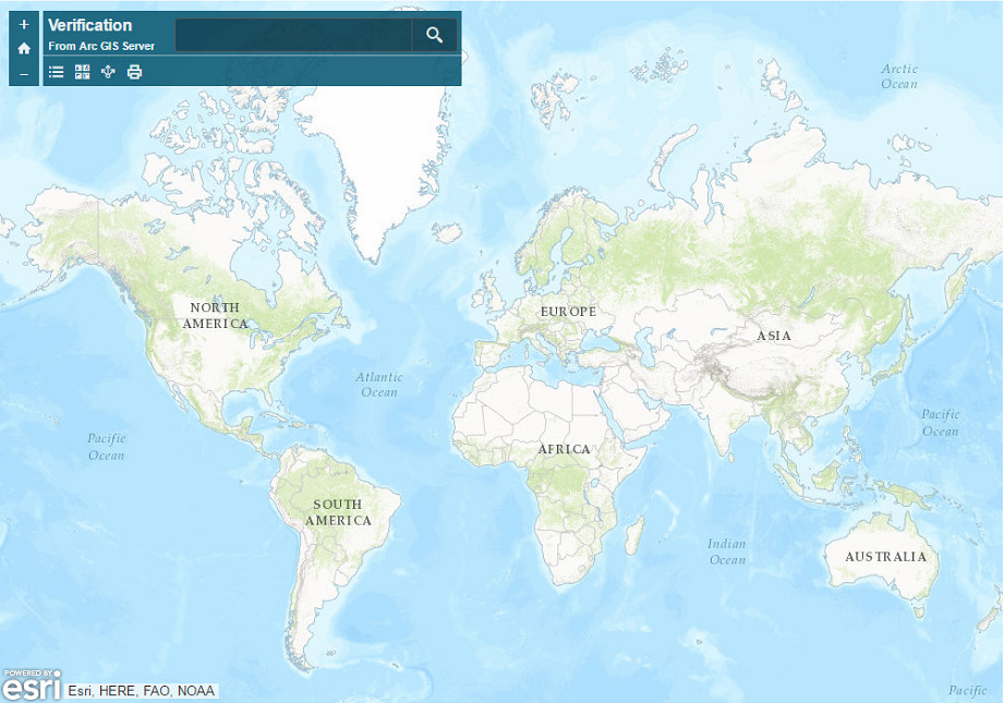

Web browser on another computer on our network:

2. Open up Dev Tools (Network) and check the request when you open the application.
What errors (if any) do you see?
LloydBronn
Any other computers, in and outside of our network. The machine is not on a .com domain. It's local to our network right now. It seems like that might be the issue. Sorry, where do I find Dev Tools?

"My issue is this: I can view the data with attachments on the web app from the web browser on the server. If I view the same page on the web browser on other computers, I can't see the data."
My guess is that you're referencing your services using http://localhost/arcgis/rest instead of your server's Fully Qualified Domain nameIn any case, the issue is that the other machines on your network can't resolve to the hostname that was used when you added your service as items to 'My Content' on ArcGIS.com.
LloydBronn
You're right. I checked dev tools and it is trying to access the local host. Our domain is only local right now (we don't have a .com domain set up yet), so I guess this is the problem. Thanks!
