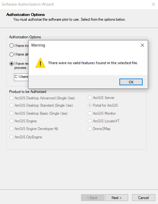

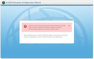

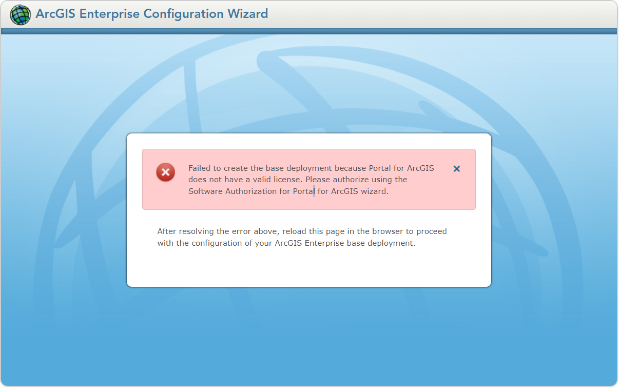

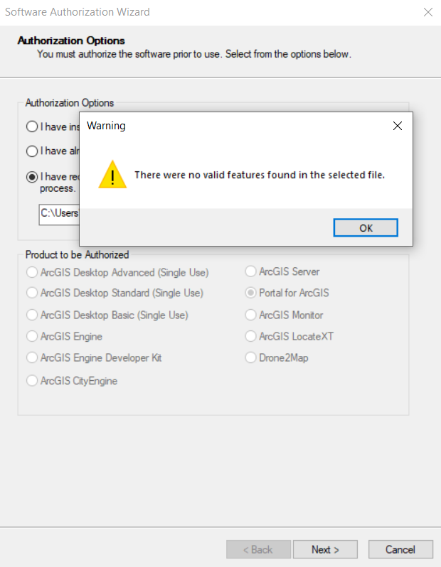

I have tried to upgrade my local enterprise deployment to 10.9.1 using Builder I got an error at Portal validation stage. I have uninstalled Portal manually and installed it again. I came back to Enterprise Builder, and got the following error (on the screenshot). I cannot find Software Authorization for Portal anywhere and I am confused, where should I authorize it. I tried Software Authorization Wizard with .json file but I got an error as well.
I'm sure there is a simple answer for that, but I can't find it out. Anyone can help me?

I have a json file, but my problem now is, where can I authorize my portal using this file? As you can see above on the screenshot, I have tried to do that in Software Authorization Wizard but it throws an error when I specify that file.

Yes I did use Builder.
Now I uninstalled Builder and installed it again, and when the configuration finished I still got the same error.

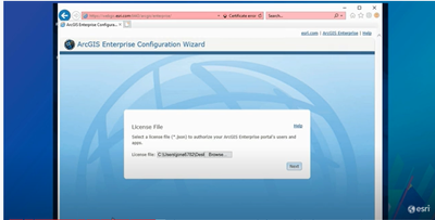

Whereas I should see something like this (screenshot taken from the Esri Events video on yt).
