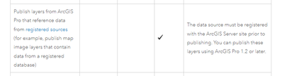

This conflicts with what I thought, but I may be mistaken. The checkmark is in the 'Hosted Feature Service' column (frozen column headers would be great in the documentation, fyi).
It's from here
https://enterprise.arcgis.com/en/server/latest/deploy/windows/about-using-your-server-with-portal-fo...
Could I get confirmation that the server has to be designated as a hosting server to be able to host registered map services?

I was actually just wondering if the hosting server designation was a requirement for being able to register GIS data to the server so it can be published as registered map services. I had thought that designating a server as a hosting server was only necessary for allowing data to be copied to that server - ie to publish hosted servers.

To my knowledge, a hosting server is not required for publishing services.
https://enterprise.arcgis.com/en/server/latest/manage-data/linux/registering-your-data-with-arcgis-s...
Hosting server is required if you want to upload data through Portal.
