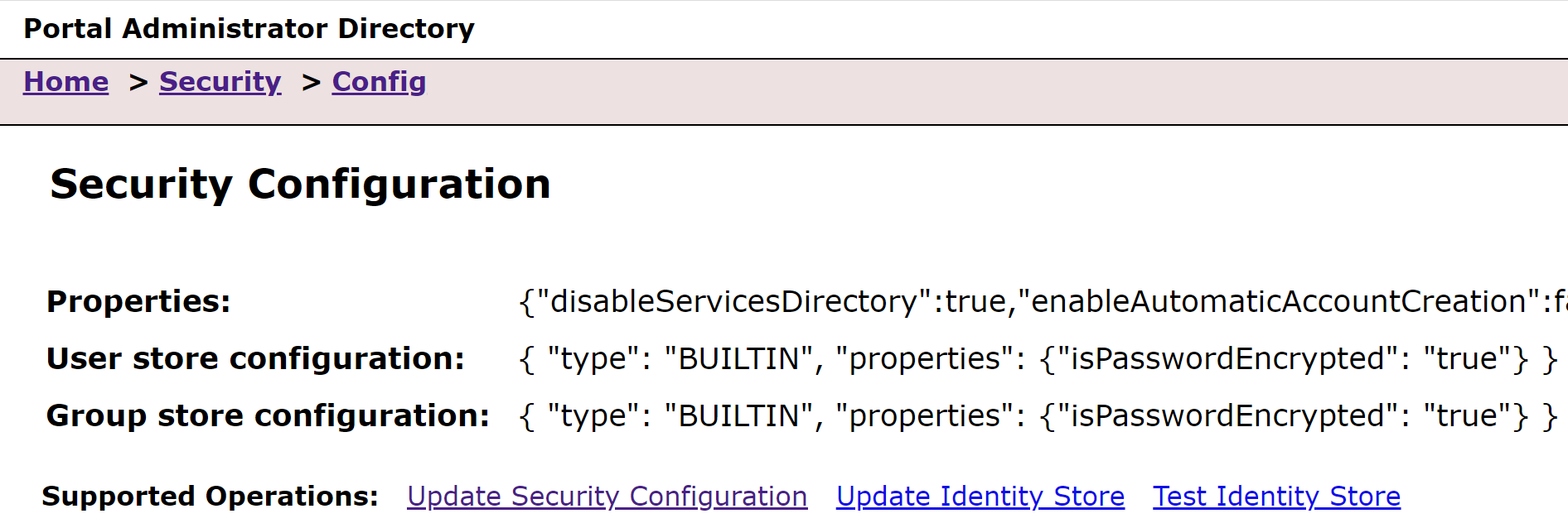

Hello,
We deployed Enterprise 10.8.1 and it has Azure AD SSO. I used this URL to configure this and it is working https://docs.microsoft.com/en-us/azure/active-directory/saas-apps/arcgisenterprise-tutorial#configur...
Now We have some groups created in Azure AD and we want to configure them with Portal so, when we create a group for certain users have certain privileges, we just add the azure group to it and we do not have to add users one by one. (we have thousands.) I was wondering if there is some way to manage this?
Can I configure group store configuration for this purpose?

With a SAML-based identity store, you'll want to include group membership as part of the SAML assertion for each user. There is a setting in the Portal settings for enabling enterprise group membership as part of the IDP configuration (under advanced settings), which will then allow you to specify the string that matches the value(s) sent in the user's SAML response from the IDP.
The group store configuration you've displayed is specific to Windows AD/LDAP group membership, so wouldn't apply in this circumstance.

Thanks, this info was really helpful. My enterprise works fine now, i was able to access and automatically i was assign to groups i created in azure and Portal using Azure object ID.
