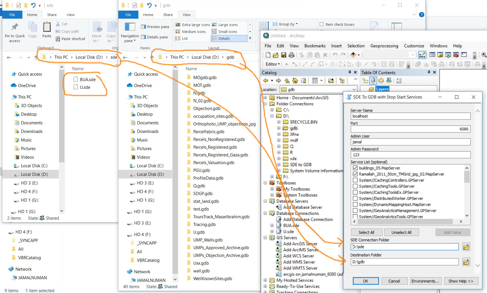

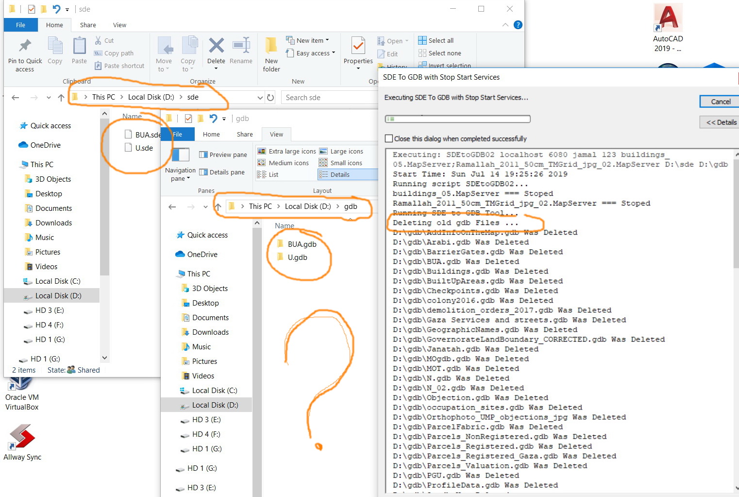

We found out that the tool will be deleting all the content of the gdb destination folder. I’m not sure if the tool can be adjusted to just delete the gdb files which have equivalent sde connection because it happens very often that some of the gdb folder have no sde connection, in this case, they will be deleted
For example, in the screenshot below, I just have two sde connections: u.sde and bua.sde, then I expect that their corresponding gdb will be deleted and replaced with the new data from the mdf. However, the tool appears to delete all gdb files
Is this still possible?

AhmadSALEH1
Jamal,
I assumed that you wanted to delete everything in the gdb folder.
Here is  an updated version of the tool that only deletes the gdb files that matches the sde connection name.

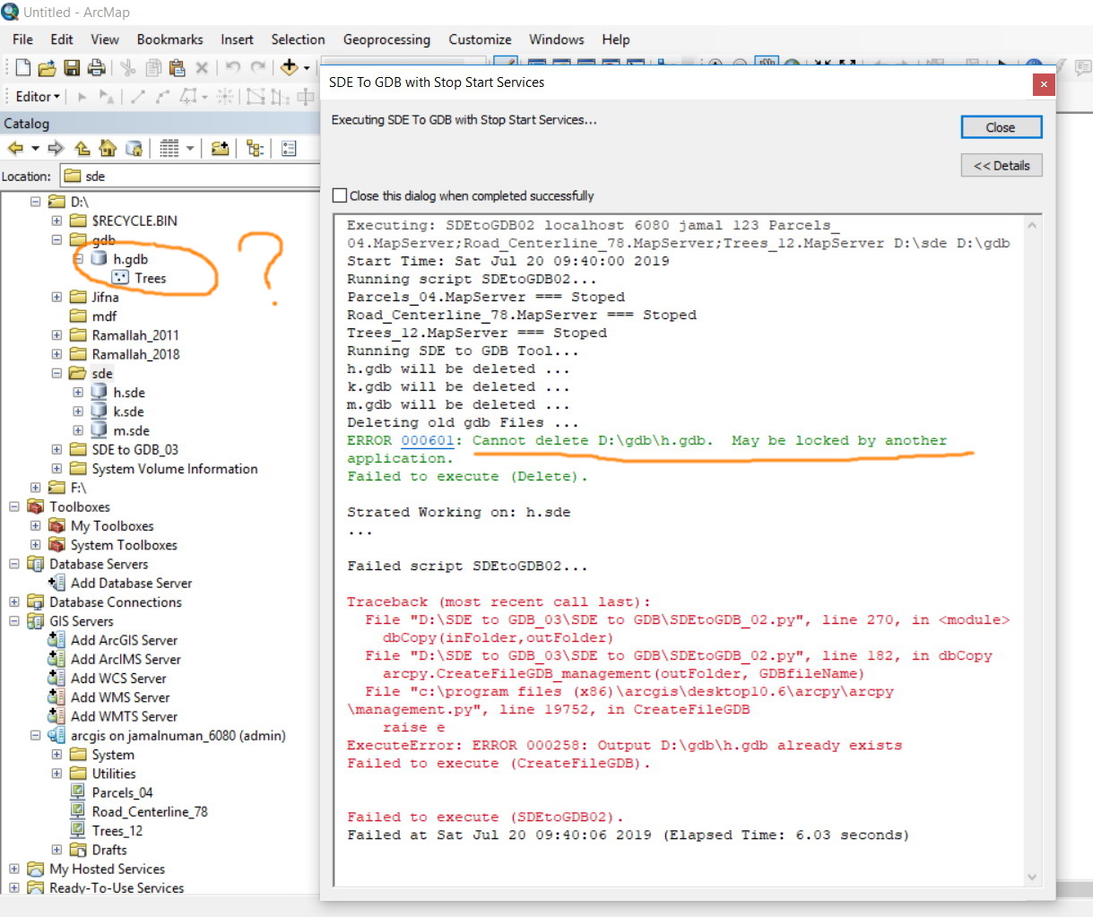

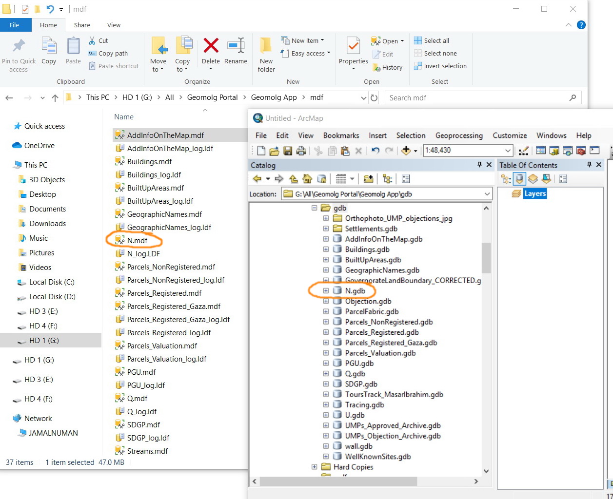

Could you please consider the error below. What could be the issue here?
Jamal Numan
Geomolg Geoportal for Spatial Information
Ramallah, West Bank, Palestine
AhmadSALEH1
Jamal,
The tool failed to delete the gdb because its being used by another application, might be due to another ArcMap session or because the gdb is expanded in the catalog (sometimes ArcMap lucks the gdb when its expanded).
Were you able to delete the gdb manually (by right click >Delete)?
Thanks,
Ahmad
JamalNUMAN
Legendary Contributor
Many thanks Ahmad for the prompt help. The delete works fine

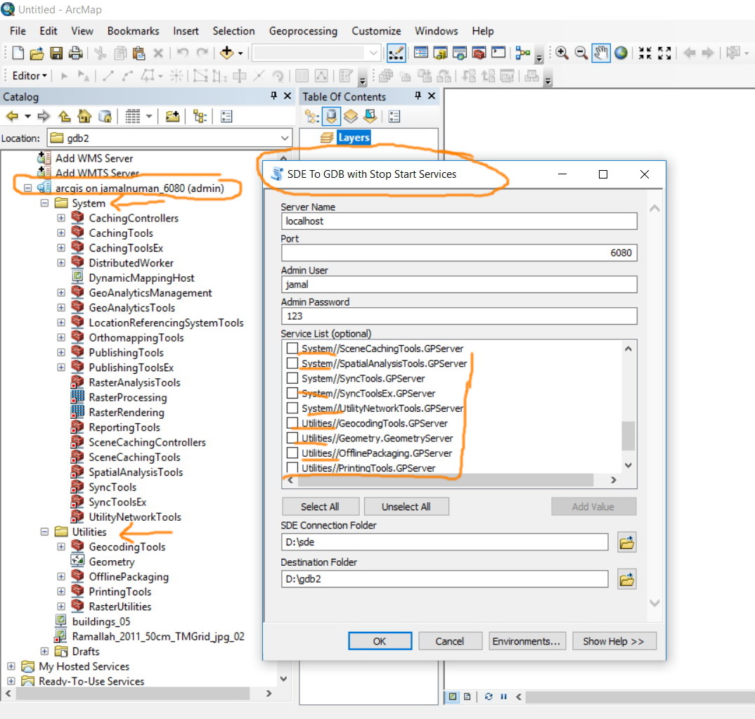

I’m not sure if it is possible not to list the default services that are included in the system and utilities folders.
Jamal Numan
AhmadSALEH1
I think this might  work

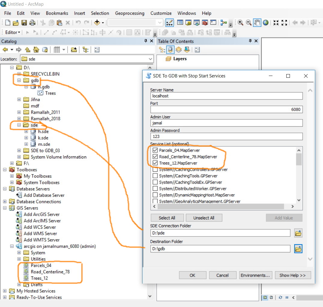

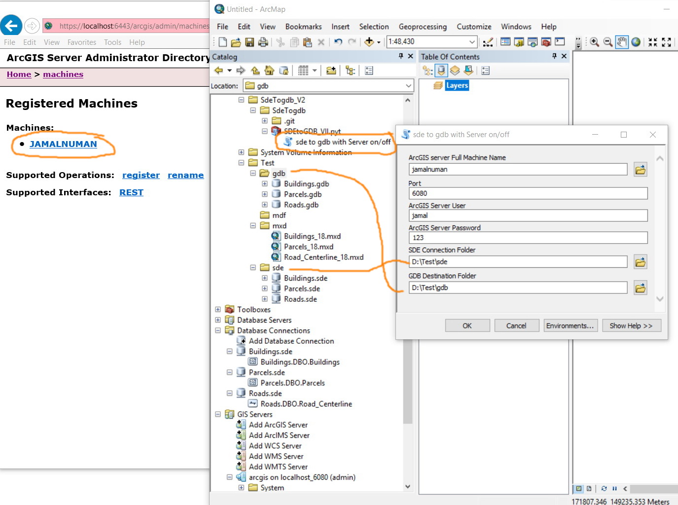

Is it something doable to stop\start the ArcGIS Server instead of stopping\starting each service? in this way, the code needs to:
Stop the ArcGIS Server
Delete the gdb
Convert the mdf to gdb
Start the ArcGIS server
Best
Jamal
Jamal Numan
AhmadSALEH1
Hi Jamal,

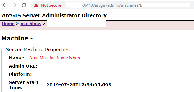

Use this one, but make sure to enter the full server machine name in "ArcGIS server Full Machine name" input box.
to get the full machine name got to:
ArcGIS Server Administrator Directory
Then go to  > machines > machine name
use the same server name as you see it in the Server Machine properties
let me know if you got into any issues using this tool.
JamalNUMAN
This has worked perfectly Ahmad. Thank you very much for the help.
