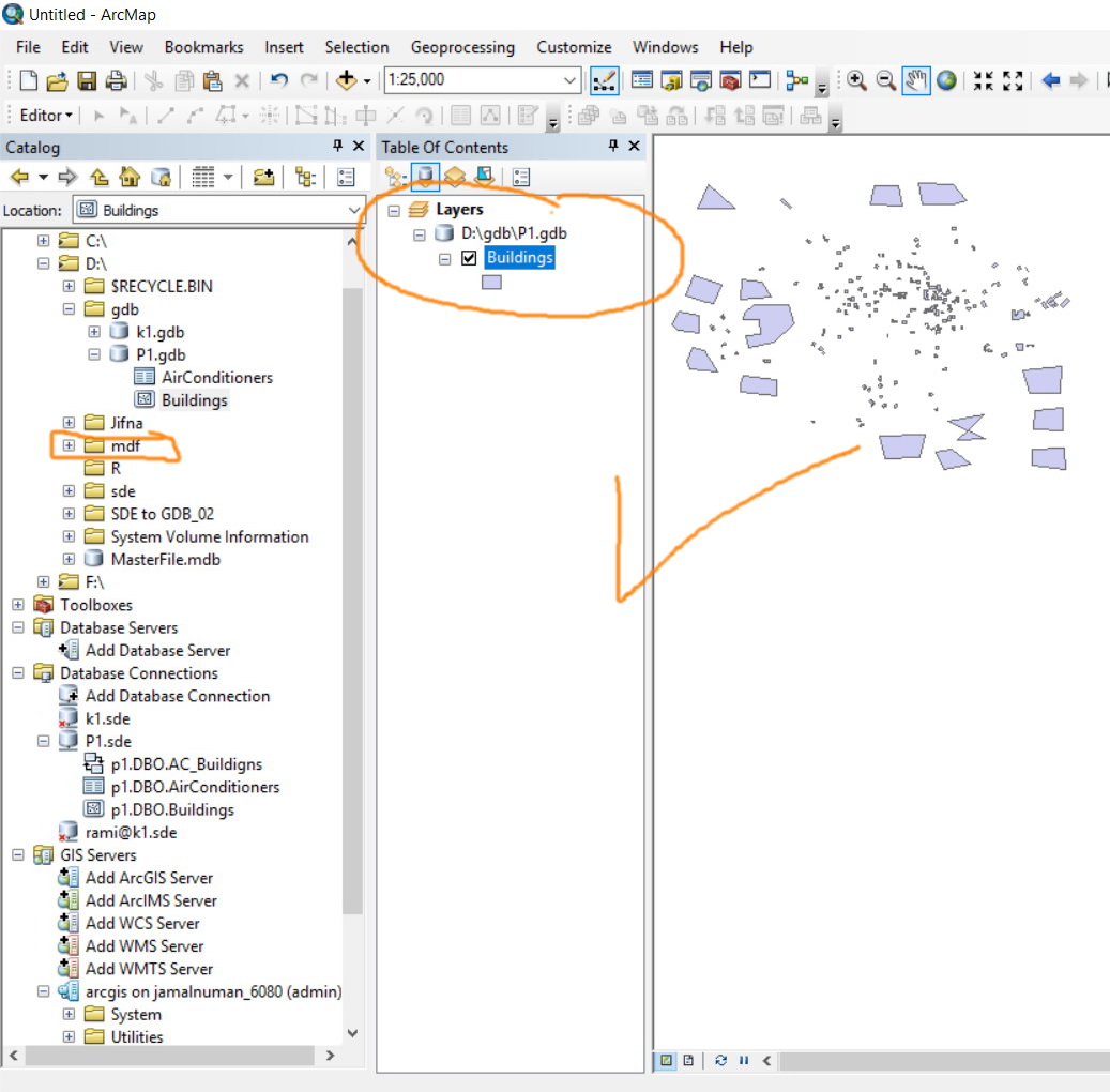

Hi Ahmad,
As we have currently two tools to convert mdf to gdb depending on whether the gdb is published or not, is there any chance to combine these two tools into one such that we can have one generic tool that convert mdf to gdb in all cases
Best
Jamal
Jamal Numan
AhmadSALEH1
Yes I think I can do that, I will send it over when its ready.
AhmadSALEH1
Jamal,
Here you go. The tool will do the following:
1- stop the selected services. (optional, if you  want to run the tool without stopping and starting the service leave the services unselected)
2- delete the old gdb's.
3- copy the sde data to the destination folder.
4-start the services again.
let me know if you had any issues running the tool.
Thanks,
Ahmad
abdullahqasrawi
Hi Ahmad
Perfect work, it is working fine with me.
