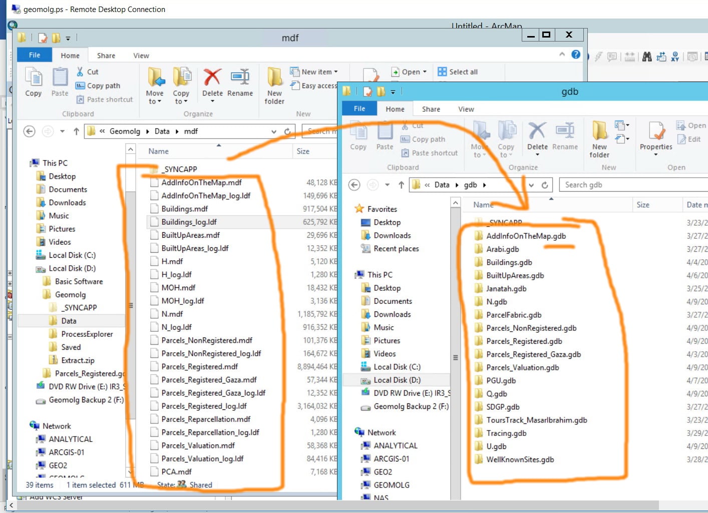

To enjoy multiusers editing environment, our data is stored in mdf files (enterprise). However, when it comes to publishing, we convert the mdf to gdb in order to gain some performance as the services that read from gdb are much faster than those read from mdf. We are wondering if there is a generic tool that can convert multiple mdf files to gdb.

I am attaching  a tool that I wrote which iterates  in   a folder were the sde connection files are saved then copies the data to a new Geodatabase.
its working fine with me, make sure  that every database connection has its own unique name to avoid overwriting the geodatabase.
