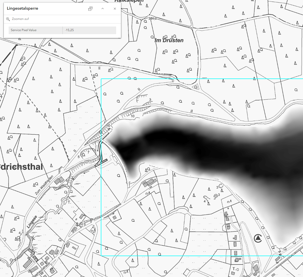

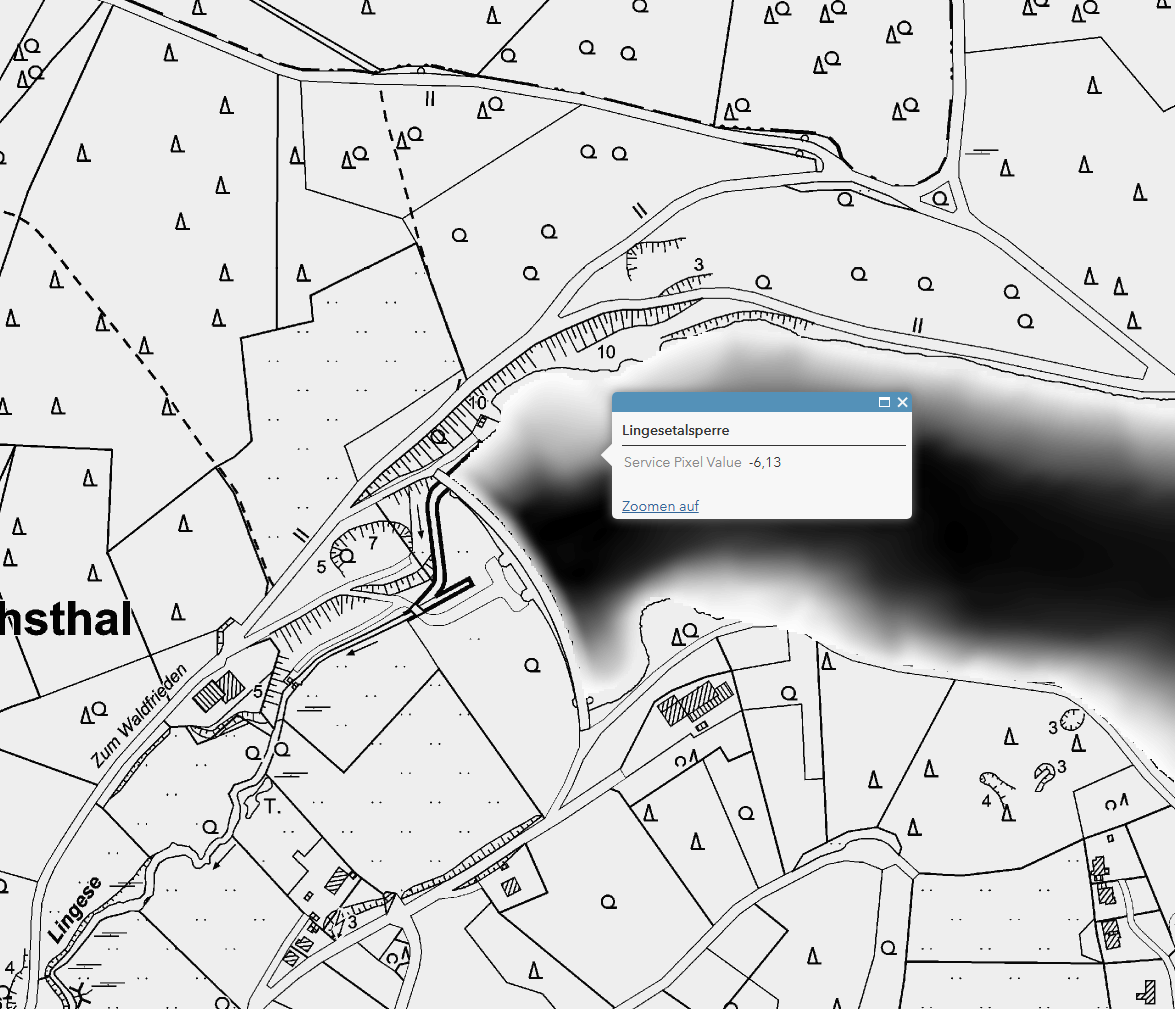

I have published an imagery layer and enabled pop-ups. In the new MapViewer, I get the pop-up but also a cyan-coloured selection frame. In the old mapviewer there is no selection frame visible. I have attached two screenshots that illustrate the problem.
How do I get rid of this selection frame? We use ArcGIS Enterprise Portal 11.3.

Just in case someone is facing the same problem: You can customize the highlight fill and outline in the map widget. So to hide the selection frame, you can simply assign colours with 0% alpha for both.
Sadly, this option is only available in the map widget of an Experience and not in the MapViewer.
