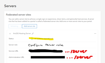

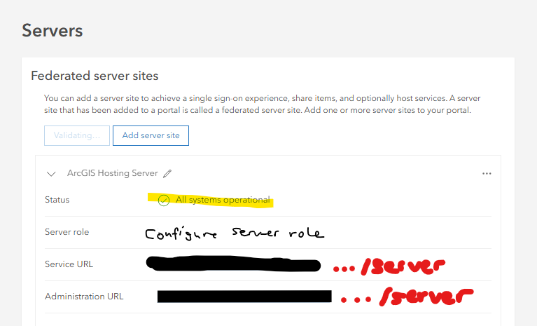

I have installed ArcGIS Enterprise 11.5. After federation, the Server validates successfully. For the Server URL the Webadaptor URL is used in both places, including the Admin URL (since this is a HA deployment).

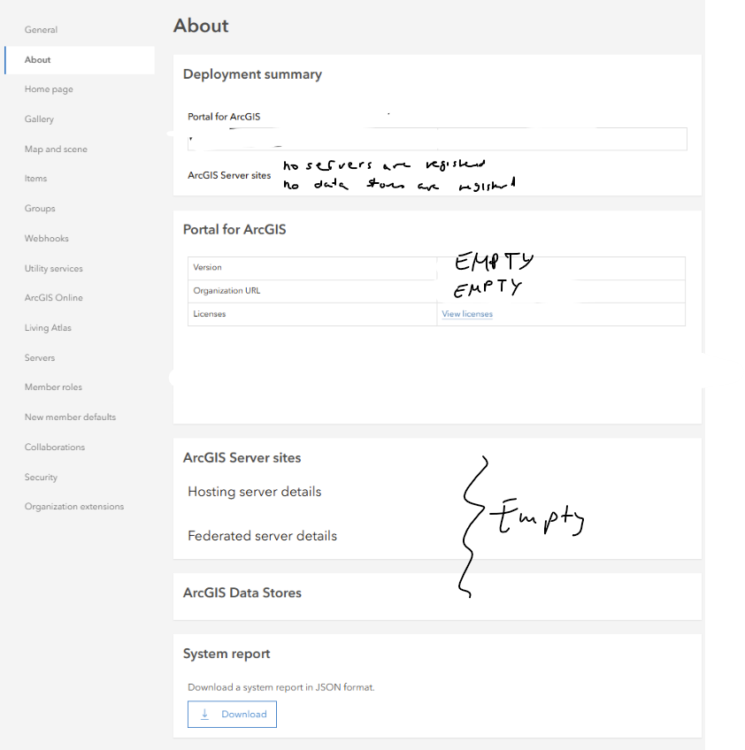

And in Settings->about there is no information listed on Server or the Data Stores.
It looks something like this (recreated):

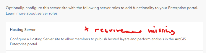

On the configure Server Role page I am unable to set the Server as Hosting Server, it claims Requirement "Relational Data Store is missing".
