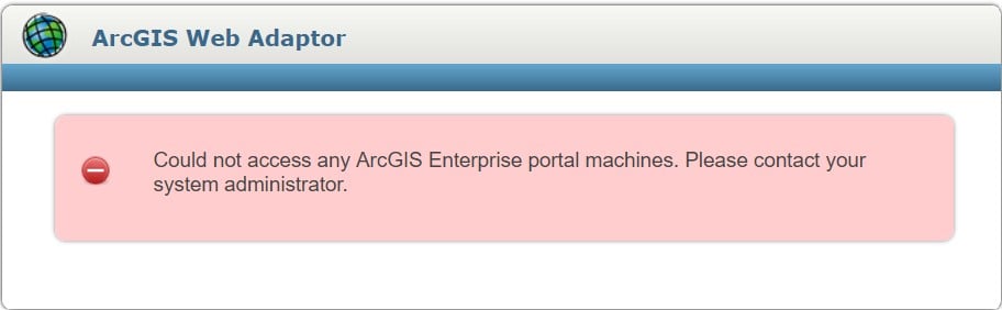

Error: Could not access any ArcGIS Enterprise portal machines. Please contact your system administrator.

Hi Community,
We are facing our ArcGIS Portal issues when electric power outage suddenly and host machine shutdown. After restarting windows, We cannot access our Portal but when we check the services, and the service for portal shown still running. Below is sample log message for portal.
<Msg time="2025-04-28T10:13:09,295" type="SEVERE" code="217003" source="Portal" process="5560" thread="1" methodName="" machine="GIS.xyz.xyz" user="" elapsed="0.0" requestID="">Error before starting configuration observer. A JSONObject text must begin with '{' at character 1 of</Msg>                            <Msg time="2025-04-28T10:13:09,295" type="SEVERE" code="217075" source="Portal" process="5560" thread="1" methodName="" machine="GIS.xyz.xyz" user="" elapsed="0.0" requestID="">Failed to start the portal. The observer's beforeStart() function returned a failure.</Msg>
We suspect a malformed or corrupted JSON configuration file, but we’re unsure which file is causing this. We have not made any recent manual changes to JSON files. We would like assistance identifying and resolving the problem without losing our current Portal configuration and content.

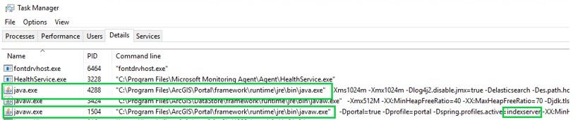

All services are running in Windows Services but we cannot see java.exe for arcgis portal in Task Manager like this photoPortal java Issues.jpg
We cannot access Portal Admin with both Web adaptor and Internal.(https://gis.mydomain.com/portal/portaladmin OR  https://gis.mydomain.com:7443/arcgis/admin)
