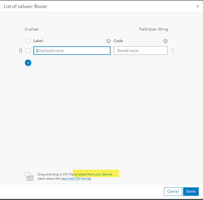

I really wish ESRI would have this option of uploading a csv file under "Data" and "Field" window, but here is the solution/workaround:
  1. Open the hosted feature layer in ArcGIS Field Maps desktop version and create a form.
  2. Add the layer that needed a list.
  3. Select "Combo" under Input Type.
  4. Click "Manage List".
  5. At the bottom, click "select from your device" and upload a csv.
  6. Click Done and save your form.
The combo list is now saved in your hosted features.

doronwen
