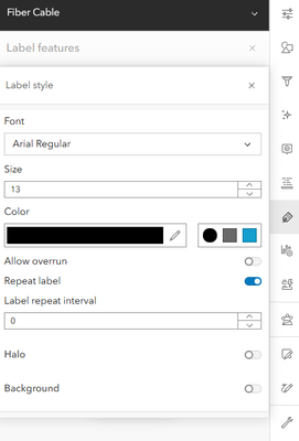

Hey all,
Probably the most simple question you'll get today, but where is the placement options for line labels, am I just blind?
Using Enterprise 11.3
Cody

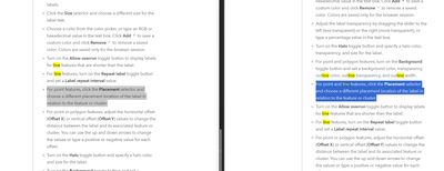

CalvinHarmin
According to this thread
https://community.esri.com/t5/arcgis-online-questions/where-is-the-label-placement-property-for-line...
Line label placement options were added around Q2/Q3 of 2024. So I wonder if 11.3 Portal map viewer was buttoned up before that option was implemented?
EDIT: It seems if you compare the 11.3 to 11.4 documentation, 11.3 does NOT include the note about line label placement.
https://enterprise.arcgis.com/en/portal/11.3/use/configure-labels-mv.htm
  • For point and line features, click the Placement selector and choose a different placement location of the label in relation to the feature or cluster.

RussRoberts
Esri Notable Contributor
Yup this was included in the 11.4 enterprise release!
CodyPatterson
MVP Regular Contributor
Hey @CalvinHarmin
Ah I see! Very unfortunate, I had thought 11.3 would have caught up to the Online version years back but it seems it much farther behind than I thought! No worries at all though, thank you for your help!
