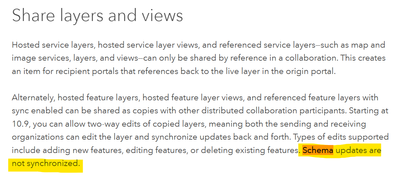

I commented on your idea post, but just for posterity for others, this is the expected behavior. Documentation does mention this:
https://enterprise.arcgis.com/en/portal/latest/administer/windows/share-content-with-collaboration-p...
This doesn't mean syncronization is totally broken if you change the schema, for example by adding or deleting a field in the source data. Rather, the adds/updates of features simply will ignore any values that do not have matching fields from Portal source to AGOL.
As you mentioned in the other post, you would have to un-share and re-share the item to your collaboration group, which would wipe out and recreate the item on AGOL side. However, it should retain the same item ID and the same service URL on AGOL side (at least from my testing). It would, unfortunately, remove any customizations to summary, description, tags, symbolization or popup customization, etc. on the AGOL item if you had made any such customizations. So it's probably always safest to customize the Portal item and not the AGOL item.
