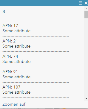

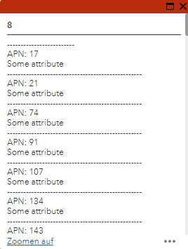

Hmmm... I can't reproduce this, they look the same to me:
Map Viewer Classic:
Web App Builder:
But, notice that the first "linebreak" line in my popups is only half length (the last one, too)? If you look at your code, that makes sense: At the end of each iteration, you add a new line and linebreak, at the start you add linebreak. So for each iteration except the first, the dashed line on top will be 2 * linebreak.
Looking at your popups, I don't see that behavior, so unless I'm missing something, this doesn't seem to be the code your popups use.
