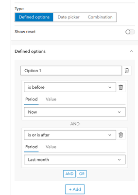

It doesn't appear to be possible, but I think something like this would be a nice addition to the Dashboards platform. A date selector allows you to create more specific / complex defined options, which is what I think you're going for:
I would submit this as an Idea here; I'd definitely vote for it!

Exactly like the Date selector! Thanks for pointing that out.  I will definitely submit my request as an idea.
Mark
