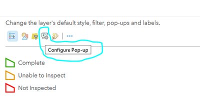

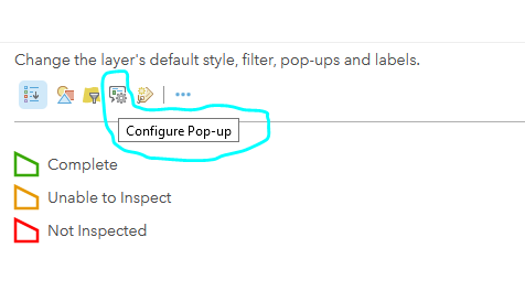

I am unable to modify the pop-up on a View Layer on Enterprise Portal 10.8.1
The tool text shows up, but no amount of clicking opens the pop-up editor.
Currently it seems the only way to modify the pop-up is to modify the source layer.
This happens both in the Visualization Tab, and on a webmap itself
