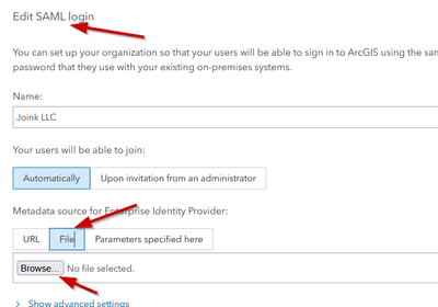

You may need to re-exchange the metadata in your AD environment with your Enterprise Portal. You may need the built-in administrator to access these settings and change them. I would have you or your IT generate a new metadata file and insert it here on Organization > Settings > Logins > Configure login
