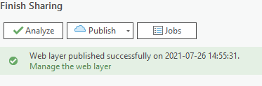

Everything during the installation was ok, the components are working fine and are installed in the right order. I can publish to the portal without any problems from Pro.

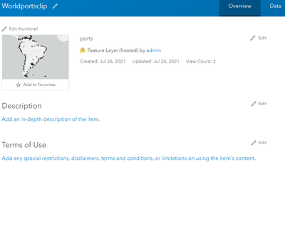

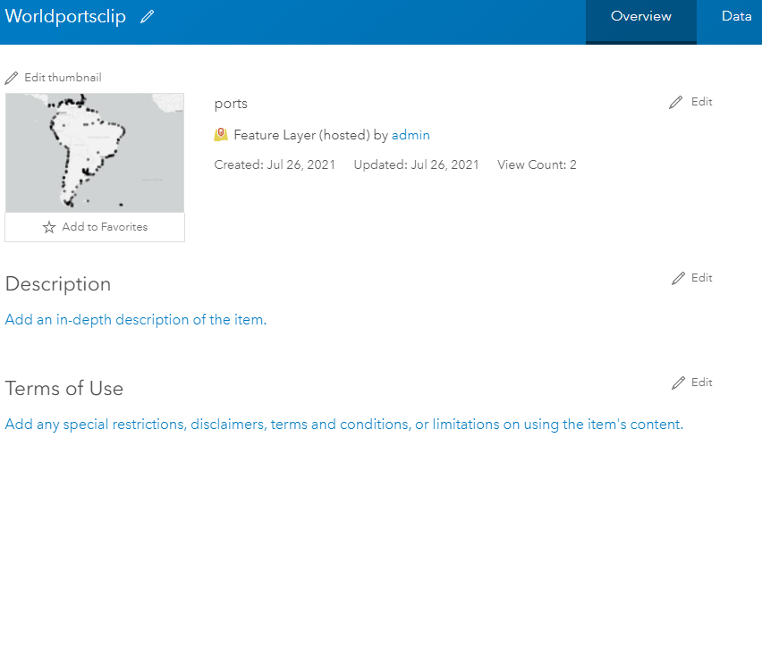

But, when I go to the published feature layer in the portal I cant see any layers in the service

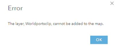

When I try to open the feature in the map viewer I get the error below, background maps opens fine. Its a 404browser error (page not found) so it does not give any clue on what's wrong

Based on that error message above, it could be that the URL used to federate ArcGIS Server to Portal isn't correct.  On the item's details page, if you click on the published URL in the bottom right corner, does that page load correctly to see the service details?
