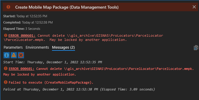

OK, so I did what you said in your most recent post.  I opened ArcGIS Pro and made a project called ParcelLocator.aprx.  Then, I used the ParcelLocator.aprx to create the ParcelLocator.mmpk and added it to ArcGIS Earth.  It worked but gave me some funny numbers in my search result outside of the parcel number, which I believe is the field attributes of the highway shields point feature class I added to the project.  I went back to the ParcelLocator.aprx and unchecked the fields in the feature class so that they wouldn't be searchable with the locator, saved it, and then tried to rewrite the .mmpk.  I received this error:

Did you close ArcGIS Earth before trying to rewrite the MMPK ? The lock may be from there. I suggest you write the MMPK in a folder A, copy it in a folder B, and use the file from folder B to add to ArcGIS Earth.
If your locator is to be used by a large number of people, updating it might be a problem for you. Because every single user of your MMPK must close ArcGIS Earth at the same time for you to overwrite the file. You could do it outside of working hours, but if a user left his session opened with an ArcGIS Earth program running, it will lock the file.

Hi Geoffroy,
Yes, I closed ArcGIS Earth and then it allowed me to overwrite the .mmpk and the locator itself, only issue I have with that is that the staff who will be using this locator may or may not exit their programs each day in order for me to perform the necessary updates.  The suggestion you made about writing the MMPK and to folder A and then pointing ArcGIS Earth to folder B, etc., I don't believe will work, because after you update the .mmpk in folder A, you then have to overwrite the .mmpk in folder B, which will present the same problem?  Or am I overthinking this one?

GeoffroyRicher-Lalonde
You are right : a user might lock your file.
The only advantage with the folder A, folder B thing is that the update of your MMPK will always work as planned in folder A. But you might have trouble overwriting the file in folder B...
