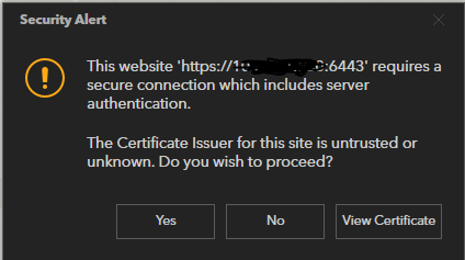

This may be a simple fix for some, but I am having trouble getting our ArcGIS Server security certificate to authenticate inside ArcGIS Earth.  I have added a couple of feature services which I published from ArcGIS Pro (3.0.2) to our ArcGIS Server (10.8) and each time I open ArcGIS Earth, I get this error:
I have tried clicking on "View Certificate" then installing it for the user and the local machine, and it does not work.  Any ideas?

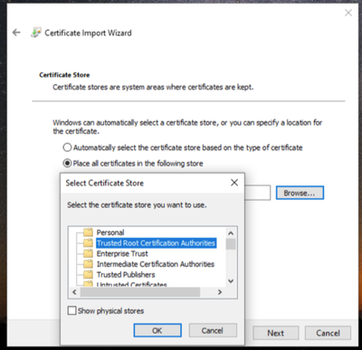

Thanks for sharing your experience with us. The reason why you received the warning is that the certificate is unknown or untrusted. Please check if the certificate is added to Trusted Root Certification Authorities Store for your ArcGIS server or not. Once the certificate is installed and added to the list of CAs,  you will be able to access the data.  Please refer to Windows' document: TLS - SSL (Schannel SSP) Overview | Microsoft Learn
