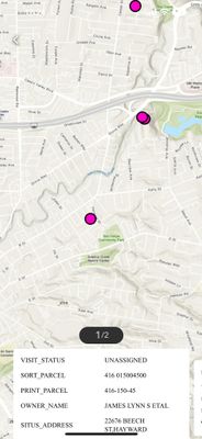

IOS Screenshot

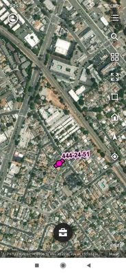

Android Screenshot (No result after blue arrow)
