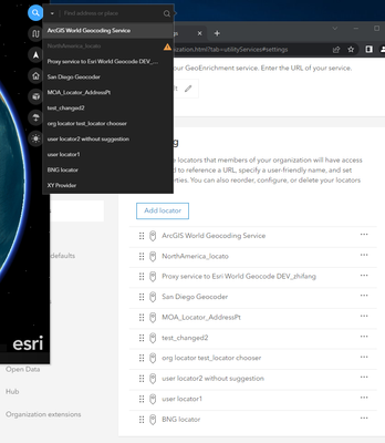

Hello @ABishop ,
Currently, we recommend our users to configure their own locator services as portal admin. For detailed instructions, you can refer to ArcGIS Online's public document: Geocoding.Once you added the locator in your portal, you will be able use your own geocode service in the geocoder dropdown:
Feel free to get back to us if there's still any confusions.

Hello @ABishop ,

Hello @ABishop. There is another way.
  1. Add your locator to a .mmpk or a .mspk file with ArcGIS Pro
  2. Add your packaged file to ArcGIS Earth
Your locator will be added in the Search dropdown.
