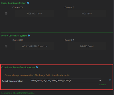

I had a look at the coordinate systems that you appear to be using for your projects and there are valid transformations, even without having the ArcGIS Coordinate System data installed. When you look at the processing options coordinate system section do you see a transformation being applied?

For the image coordinate system I was using WGS 1984 for the xy and EGM96 Geoid for the z. I also tried WGS 1984 for the z since that was the default in older versions of D2M. For the Project Coordinate system I usually try for the NJ State Plane NAD 1983 StatePlane New Jersey FIPS 2900 feet and NAVD88 (ftUS), but I have tried other systems to try and get a result. I have gotten Transformations applied and when I match the coordinate systems I have gotten the message that no transformation is required but if I ask for a 3d textured Mesh I get the same runtime error in the processing log referring to the transformation I still can't find.

I had a flight from New York state that I tried processing in those coordinate systems as a general test. A transformation is automatically applied if you have the ArcGIS Coordinate system data installed. The processing completed with no errors for the 3D mesh generation. I wasn’t using any GCPs in my test, have you tested without the GCPs and received the same behavior?
I'd like to see your data to help troubleshoot this faster. If you are open to sharing the images and GCPs, please let me know. You can email me (mbarker@esri.com) and I will get a shared folder going.
Otherwise, please send the processing report from the project and a new d2m.log with the logging level set to debug.
