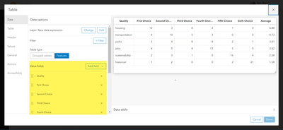

KenBuja
MVP Esteemed Contributor
If you're getting back a valid FeatureSet, you have to configure the table to use the fields you want. In this example, I've calculated a FeatureSet with Arcade and had to specify the fields I wanted to show in the table by clicking the "Add field" button in the Value fields section.
