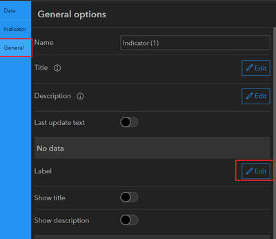

Just try
$datapoint["sum_number_of_citations_issued"]
For No Data value, just change the Default Label to 0.

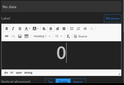

Just try
Think Location
by Anonymous User
Not applicable
Thank you so much! Is this a new feature with 10.9.1 or have I been blind! So easy. I knew it had to be. Thank you, thank you!
